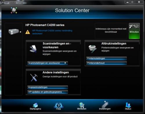

Kan je via de printertoolbox niks aanpassen? Zie tekst verder in dit bericht.

1. In the HP Solution Center, click Settings, point to Print Settings, and then click
Printer Toolbox.
NOTE: You can also open the Printer Toolbox from the Print Properties dialog
box. In the Print Properties dialog box, click the Features tab, and then click the
Printer Services button.
The Printer Toolbox appears.
2. Click the Estimated Ink Level tab.
The estimated ink levels for the ink cartridges appear.

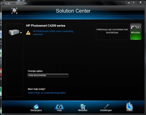

Inktniveau's kan je normaliter ook checken via de software, HP Solution Center...als je Solution Center open klikt staan de inktniveau's rechts bovenaan op het scherm.
