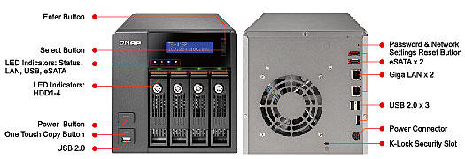

Hardware Spec.
CPU Marvell 6281 1.2GHz
DRAM 512MB DDRII RAM
Flash Memory 16MB
HDD 4 x 3.5" or 2.5” SATA I/II HDD
HDD Tray 4 x hot-swappable and lockable tray
LAN Port 2 x Gigabit RJ-45 Ethernet port
LED Indicators Status, LAN, USB, eSATA, HDD 1, HDD 2, HDD 3, HDD 4
USB 4 x USB 2.0 port (Front: 1; Back: 3)
Supports USB printer, disk, pen drive, USB hub, and USB UPS, etc.
eSATA 2 x eSATA port (Back)
Buttons Power button, USB one-touch-backup button, reset button
LCD panel Mono-LCD display with backlight and buttons for configuration
Alarm Buzzer System warning
Form Factor Tower
Dimensions 177(H) x 180(W) x 235(D) mm
6.97(H) x 7.09(W) x 9.25(D) inch
Weight Net weight: 3 Kg (6.61 lbs)
Gross weight: 4.6 Kg (10.14 lbs)
Sound Level (dB) W/o HDD installed: 33 dB
Stand by: 33.2 dB
In operation: 35.1dB
(Background: 25.5 dB)
Power Consumption (W) Sleep mode: 11W
In operation: 26W
(with 4 x 500GB HDD installed)
Temperature 0~40˚C/ 32~104°F
Humidity 0~95% R.H.
Power Supply Input: 100-240V AC, 50/60Hz, Output: 12V DC, 10A, 120W
Secure Design K-lock security slot for theft prevention
Fan 1 x quiet cooling fan (9 cm, 12V DC)
