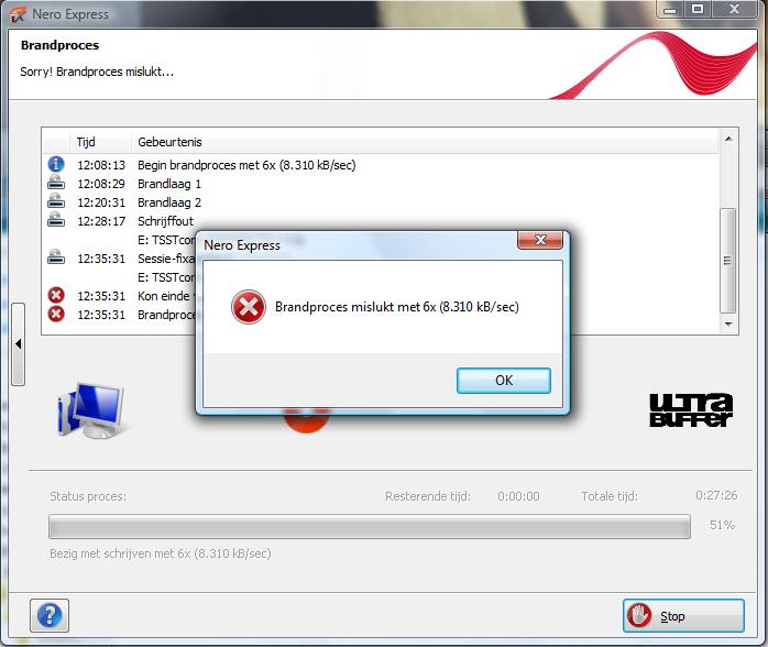

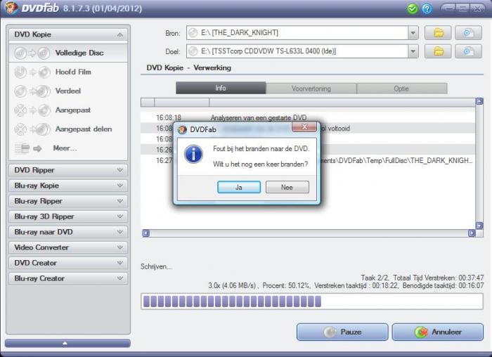

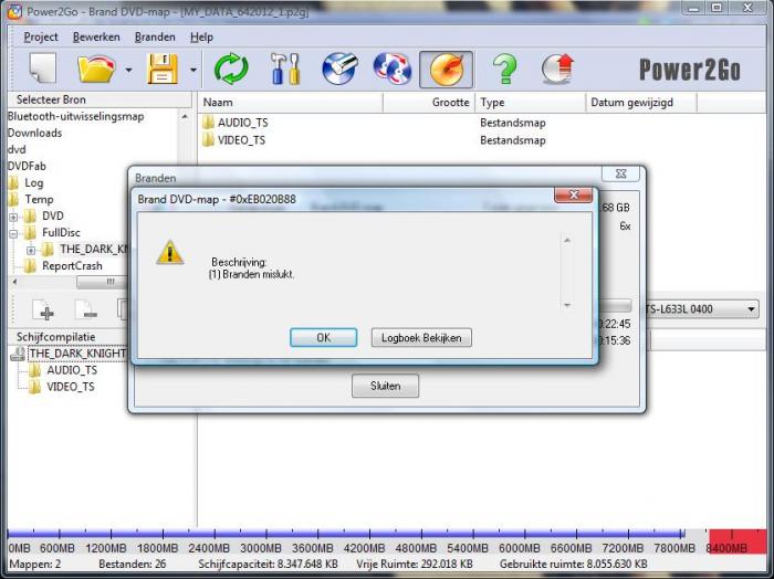

Ik heb bij de volgende screenshots Nero, DVDFab en Power2Go gebruikt.
DVDFab:
DVD kopie - volledige disc - DVD 9 - Foutmelding tijdens branden.

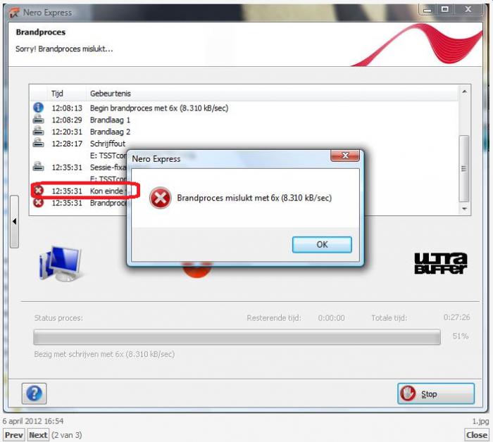

Nero:
Nero express - DVD-Video bestanden - Video TS bestanden toegevoegd - Branden - Foutmelding

12:08:29 #39 Text 0 File DVDPlusRW.cpp, Line 637
Start write address at LBA 0
DVD high compatibility mode: Yes
12:08:29 #40 Text 0 File ThreadedTransfer.cpp, Line 273
Pipe memory size 83836800
12:20:31 #41 CDR -1206 File DVDPlusDualLayer.cpp, Line 2227
Burning Layer 2
12:20:31 #42 Text 0 File DVDPlusDualLayer.cpp, Line 2236
Perform layer 1 to 2 jump before writing at address 1573536 (1802A0h)
12:28:17 #43 SPTI -1135 File SCSIPassThrough.cpp, Line 215
CdRom0: SCSIStatus(x02) WinError(0) NeroError(-1135)
CDB Data: 0x2A 00 00 18 15 20 00 00 20 00 00 00
Sense Key: 0x03 (KEY_MEDIUM_ERROR)
Sense Code: 0x0C
Sense Qual: 0x00
Sense Area: 0x71 00 03 00 00 00 00 0A 00 00 00 00 0C
Buffer x1c00bd80: Len x10000
0x00 00 01 BA 44 F1 3E C4 94 B1 01 89 C3 F8 00 00
0x01 E0 07 EC 81 00 00 00 00 00 00 00 00 00 00 00
0x00 00 00 00 00 00 00 00 00 00 00 00 00 00 00 00
12:28:17 #44 CDR -1135 File Writer.cpp, Line 306
Write error
E: TSSTcorp CDDVDW TS-L633L
12:35:31 #45 Text 0 File DVDPlusRW.cpp, Line 904
EndDAO: Last written address 1578272
12:35:31 #46 CDR -1176 File WriterStatus.cpp, Line 292
Session fixation error
12:35:31 #47 TRANSFER -24 File WriterStatus.cpp, Line 292
Could not perform end of Disc-at-once
12:35:31 #48 Text 0 File DVDPlusDualLayer.cpp, Line 1452
SetDriveCaps: Set LAST LBA of layer 1 to 0
12:35:31 #49 Phase 38 File dlgbrnst.cpp, Line 1767
Burn process failed at 6x (8.310 kB/sec)
12:35:31 #50 Text 0 File SCSIPTICommands.cpp, Line 267
SPTIDismountVolume - completed successfully for FSCTL_DISMOUNT_VOLUME
12:35:37 #51 Text 0 File Cdrdrv.cpp, Line 11592
DriveLocker: UnLockVolume completed
12:35:37 #52 Text 0 File SCSIPTICommands.cpp, Line 430
UnLockMCN - completed sucessfully for IOCTL_STORAGE_MCN_CONTROL

Power2Go:
Video/Foto schijf - DVD branden - branden - foutmelding
Ook hier heb ik een logbestandje van:
User Name : HP
Company Name : Hewlett-Packard
CDKey :
OS Version : Vista Personal Service Pack 2
C:\Program Files\CyberLink\Power2Go\Power2Go.exe : Version 5.6.0.3919
CBS.dll : Version 7.7.2511
Total physical memory : 2047MB (2097151KB)
Free physical memory : 1791MB (1834336KB)
Memory load : 41 percent
Number of CPU : 2
CPU Name : Intel® Core2 Duo CPU P7350 @ 2.00GHz
CPU Speed : 1995 MHz
6.4.2012
Task Type : Gegevensschijf -> Brand DVD-map
17:17:53, File(cl_DVDFolderBurning.cpp), Line(93)
-> Begin burning process
Current drive: <E: TSSTcorp CDDVDW TS-L633L 0400>
Current writing speed(x): 6.0
====== Disc Info =======
Disc Type: DVD+R DL
Disc Status: Blank, Appendable
Num. of Sessions: 1 Num. of Tracks: 1
Book Type: DVD+R DL
Track Path:
Opposite Track Path
Diameter Length: 120mm Layer Counts: 2
Data Area Start PSN: 196608 End PSN: 16580607 End PSN on Layer 0: 2086912
End PSN : 120mm Layer Counts: 2
Disc Capacity: 4173824LBs
Free Size: 4173824LBs Used Size: 0LBs
Burn option: w/ buffer underrun protection
Burn option: w/o simulation
Burn option: w/ close disc
Burn option: w/ verify disc
MinAllowLBA: 265696, MaxAllowLBA: 2086912
Drive accepted LBA: 2047680
Burn mode: PACKET_INC
17:18:23, file(cl_DVDFolderBurning.cpp), line(1134)
-> Begin new track
17:18:23, file(cl_DVDFolderBurning.cpp), line(1150)
-> Write data
17:40:31, file(cl_DVDFolderBurning.cpp), line(1191)
-> End write
Last write LBA: 2227648
17:40:31, file(cl_DVDFolderBurning.cpp), line(1202)
-> End new track
Error Code : 0xeb020b88
Alvast bedankt.
Gr. Tom
aangepast door tomm

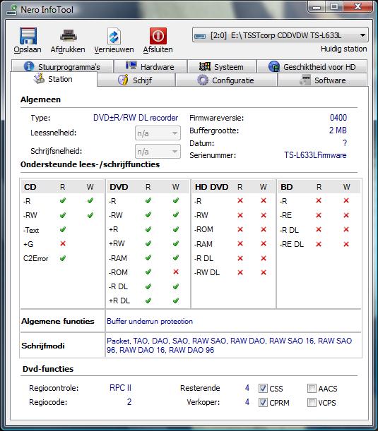

Je gebruikt Nero.
Ga dan via start naar alle programma's.
Open de map van nero en klik er op nero infotool.
Voer de test uit.
Achteraf krijg je een scherm waar je kan aflezen welke types je schrijver ondersteunt zoals voorbeeld hieronder.
Jammer dat de info niet af te lezen is van je tweede afbeelding uit bericht 5, vooral de voorlaatste melding.
Je kan ook altijd eerst een simulatie doen voor je effectief gaat branden, zo hoef je niet telkens het schijfje weg te gooien.
